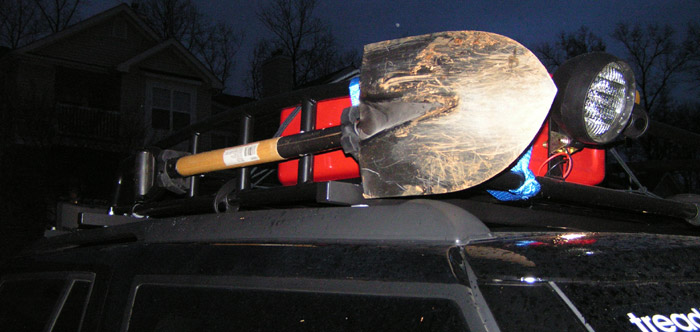

The only way to fill in these shadows is to have light above the line of sight, so yep, that means roof lights. Currently I have a very simple, cheap, yet fairly effective rack of tractor lights ($20 a pair) mounted to an aluminum extrusion. They are low enough that they cause minimal drag, yet bright enough to fill in the shadows. I'd eventually like to replace them with some decent lights, as I have learned... you get what you pay for.

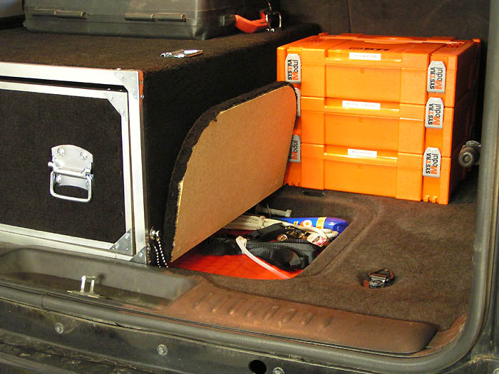

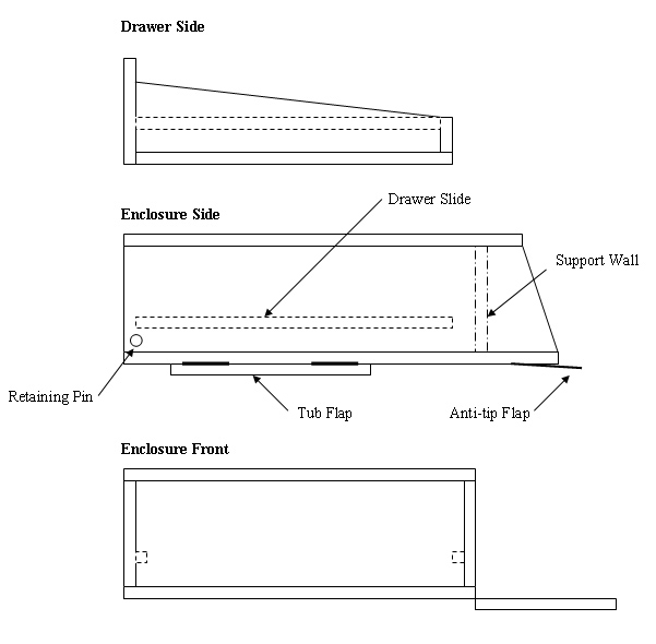

I started looking around for some ways to store my equipment, and with the combination of a custom built drawer and a few tool cases I think it's looking a whole lot better:
The drawer unit was built using a combination of 1/2" and 3/4" MDF:
Since I didn't want to lose ANY potential storage space in the truck, I build a side flap that covers the well in the rear trunk:

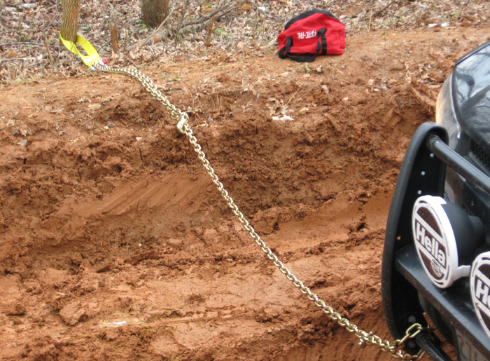

Do you have any front recovery hooks or mount points now?
My truck came with stock front tow hooks. They are however a very open design, and I really don't trust them much (straps can fall off easily). This is a big push for the new front bumper.
