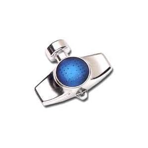

Nifty project, I suppose with a strainer you could drop the intake into a nearby lake or creek for longer showers!
lcsodiver
Yep thats what I do :bike_rider: here is what I use for a prestrainer.....
Sprinkler
and here is the quick disconnects that I use.....
Quick Disconnect
