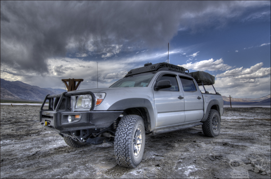

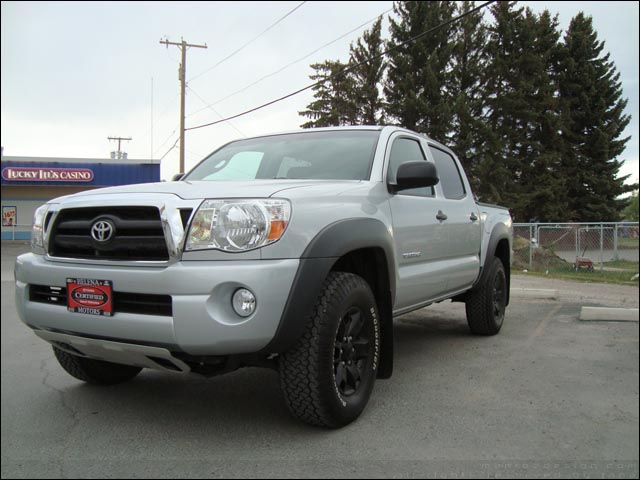

A couple months later we had located our truck on the lot at Helena Motors. There she was: a 2008 Toyota Tacoma double cab 4WD TRD Rugged Trail Edition in Silver Streak Mica with all factory options. Engine is the 4.0 liter V6 VVTi and tranny is the 5 spd Auto A750F. Birth date of 02/08, built at the NUMMI plant in Fremont CA, made in USA!

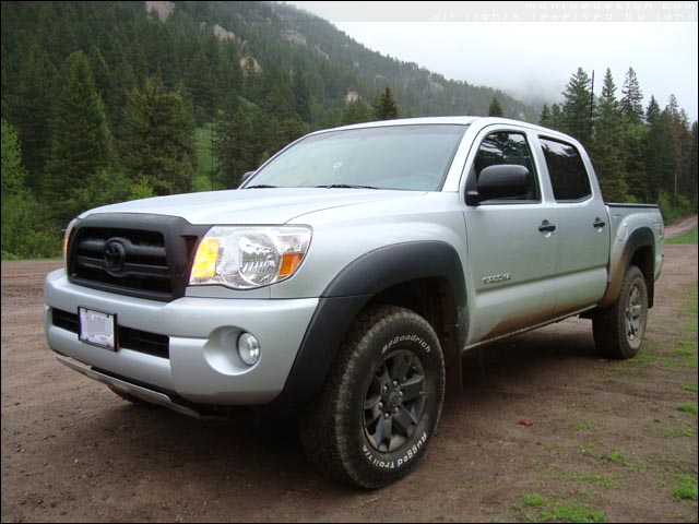

Here's how she looked the day we brought her home!

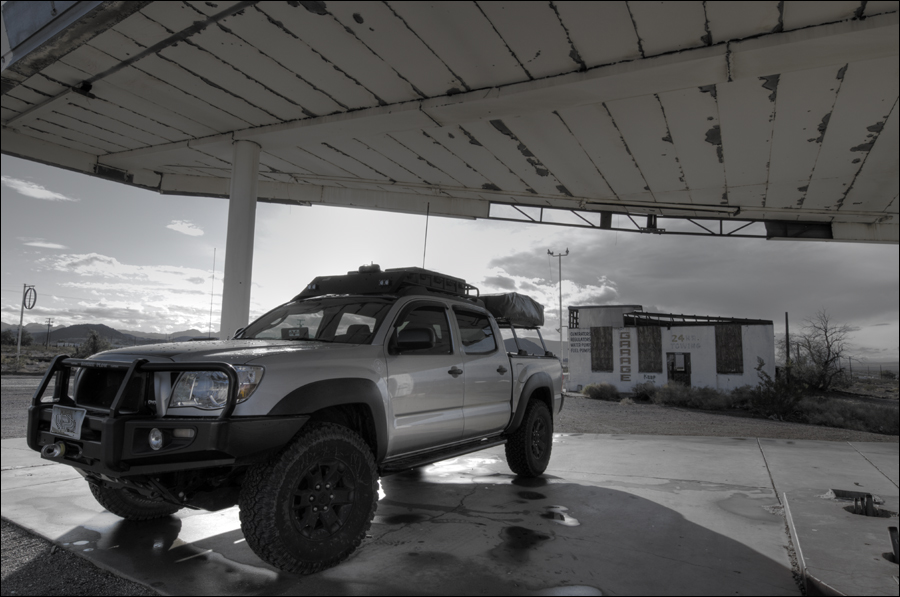

And how she looks today

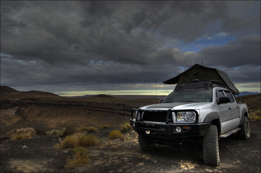

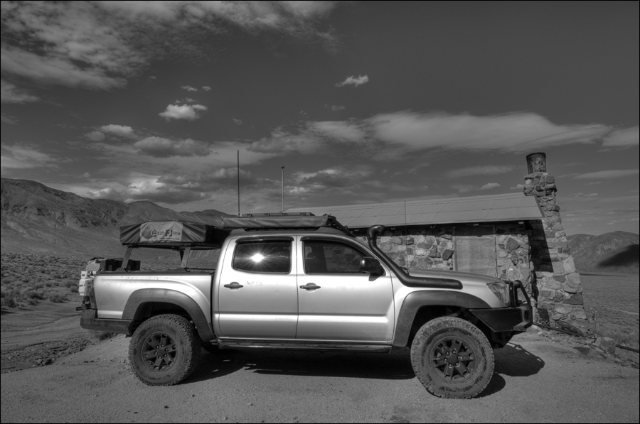

Older pics that are still cool ;)

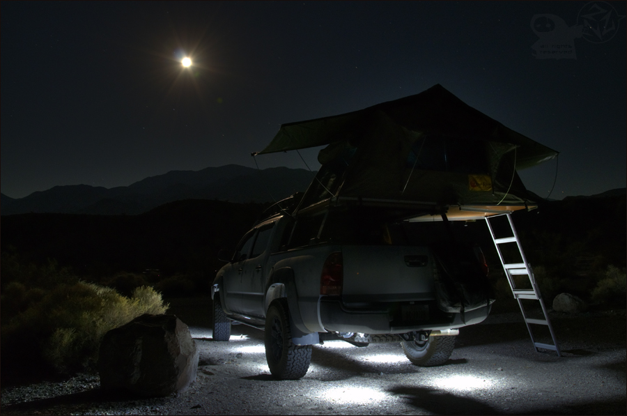

- EeziAwn 1200 series rooftop tent
- Engel MT35 fridge/freezer with transit bag and slide-lock
- FrontRunner Bakkie bed rack for tent mount
- Frontrunner 40L footwell water tank
- Shurflo water pump with shower sprayer head
- ExpeditionOps shower mat
- Shower/privy enclosure
- PETT portable potty system
- (2) Scepter MWC
- 5lb propane tank
- Two burner Partner Steel stove
- ARB 4ft awning

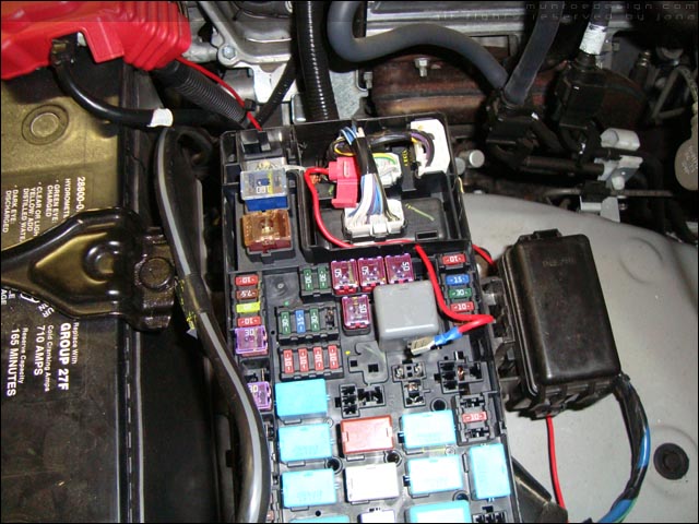

barlowrs, your build thread was very inspirational so I stole some of your ideas. In particular the fuse block mounting plate, now I just need to get the winch solenoid stuffed under there :costumed-smiley-007

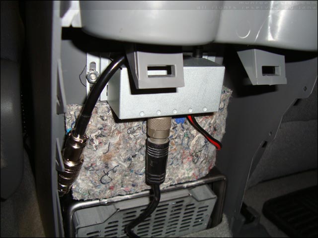

CB install. I chose the Cobra 75 WX ST for it's compact form factor and all controls on the handset.
I mounted the main unit in the rear of the center console underneath the cupholders.

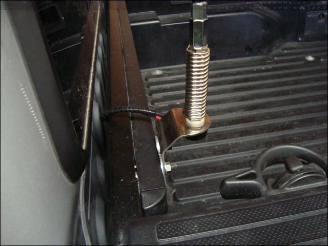

routed the antenna cable out to front of the bed, fabbed a mount and grounded to the frame underneath. Later I moved the mount to the passenger side. Even later I moved it to the roof rack..

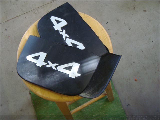

I don't know why Toyota makes these flaps so long, would've smashed 'em the first time we got off road, so they got trimmed.

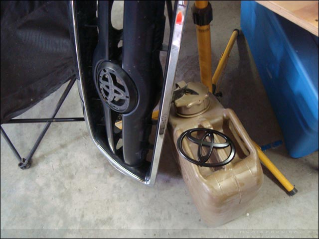

i suffer from chromaphobia so we painted the original emblem black which got me thinking...
then we painted the entire grill and surround black and she looked like this for awhile

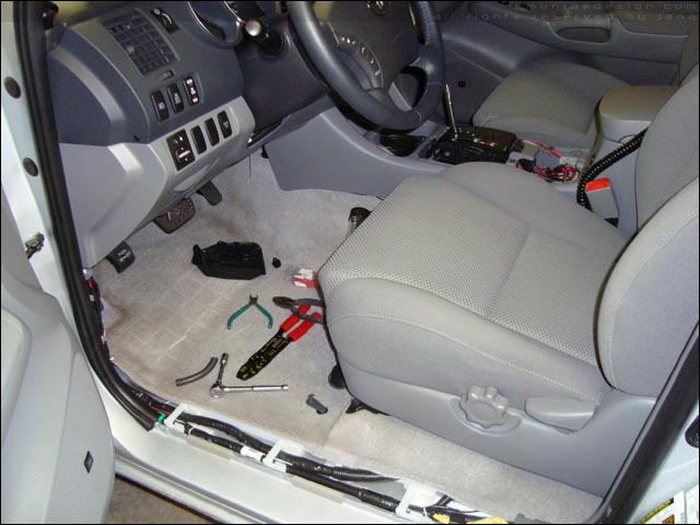

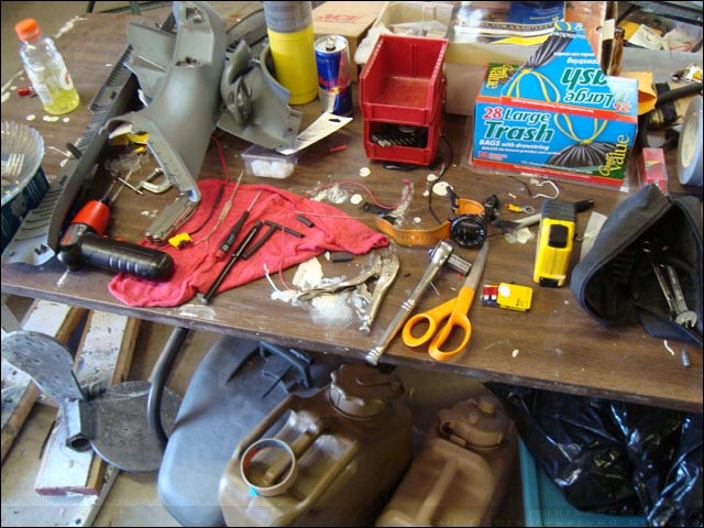

blueprinting the rear cab wall for future ref.. also wanted to see how the JBL amp and sub were set up..
here's a pic of the wiring for the fog-lights anytime mod, minus the relay. the how-to is in my bookmarks somewhere so if anybody wants a link lemme know..

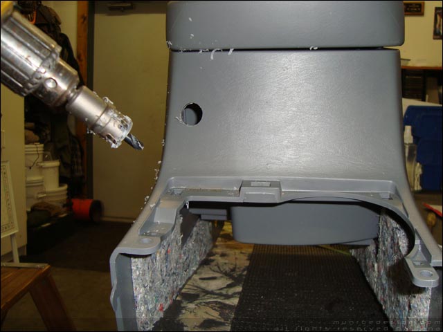

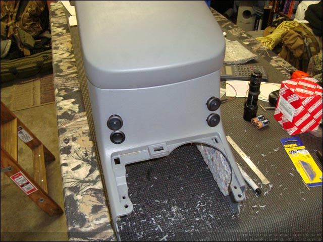

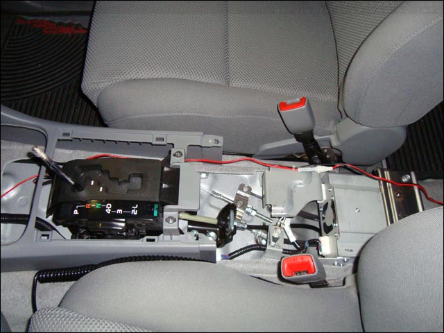

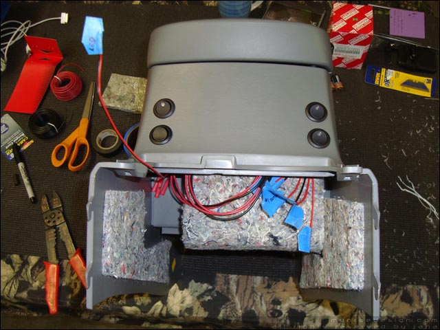

center console removed in prep for switches install
used a 3/4 hole saw for the led rocker switches

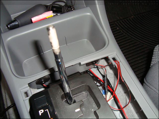

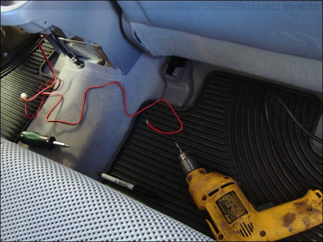

two superflux orange LEDs installed in front cupholders, wiring incomplete in this pic..
switches installed, leads wired and labled.

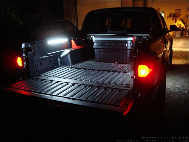

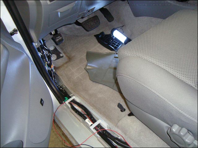

bed lights and step lights

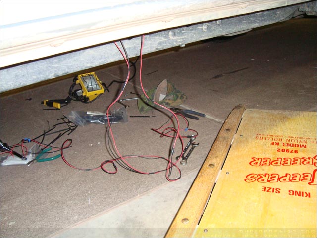

Installing the white LED lightbars in the bed, one on each side under the bedrails, and one on each outer frame under the doors
wiring all 4 LED lightbars together
wiring up into the cab to the switch, came in on a bedplug under the drivers seat
a mess lol

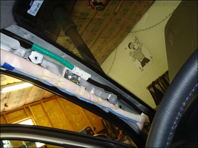

wiring up into the 3 position rocker switch and splicing into the dome light ground circuit so that I have 3 options for the bed/step lights: 1) all the time on, 2) all the time off, or 3) behave like dome light. I like this part as the lights will come on with lock/unlock just like the dome light..
drivers side A-pillar is where i tapped into the dome light ground
bed lights and step lights install complete

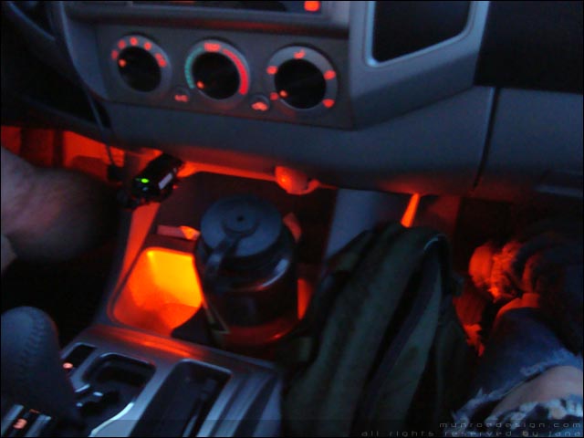

cockpit LEDs install complete, the orange matches the dash lights very well
