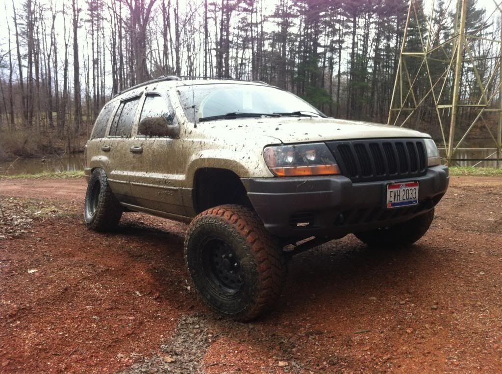

Finally got to take it out and finally test it on some trails, I'm pleased with the way it performed, however a locker would do wonders for it and include sliders and a skid plate and it ought to go wherever you point it, within reason that is, not bad for a soccer mom suv
here's a few pics from this weekend
