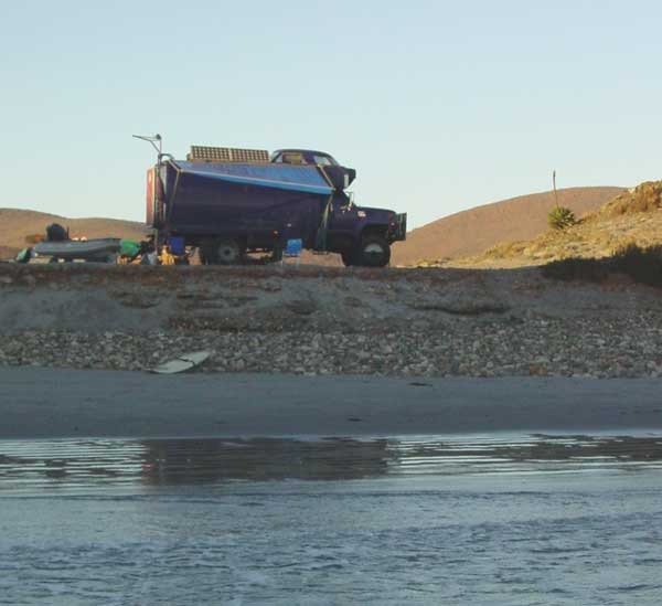

    We have a Kyocera 120 and a K60 (space limitations) on the roof of our ATRV with a RV Power Products Model 2000E Charger Controller/Booster. During our entire trip to the Arctic Circle last August/Sep I never had to use the genset to re-charge the five (yes, [I]five[I]) deep-cycle batteries on the trailer.
    This is overkill, but I like to err on the positive side. When we set up our solar system on the house in Baja six years ago we determined what our 'needs' would be, figured out the number of pv panels/batteries and doubled it.
