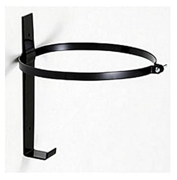

Here's another style.
http://www.amazon.com/Stromberg-Carlson-2020JR-Bottle-Rack/dp/B003VAUQFA

I had a buddy make me up a custom aluminum 11# propane bottle mount. They are not always the easiest size to find (Home Depot sells them online) but they are small and more portable than the big 20# units.
You can buy similar tank mounts online for around $120.00 (http://www.amazon.com/BKT-2286-Mounting-Worthington-Manchester-diameter/dp/B00OCDRB94).

Here is how I did mine...just made up one that welded in between the baskets for my gas and water cans. Sits behind the DeeZee tongue box. I used some rubber and glued it with construction PL around the inside so the tank doesn't move or rub on metal.
dstock
I want to mount 2 full size tanks to the front of my M101a1. They currently ride in the bed in milkcrates but I'd rather have them on the front outer wall of the bed on either side of the tongue box. I'm torn between the couple of mounts above as the first one looks beefy but has no bottom support, the less one looks less beefy but has a hook to support the bottom. Ideally, something that locks would be great.
