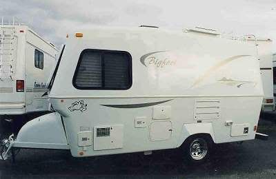

    A very successful combination of trailer and Fuso was built by Carl Hunter of Vancouver BC. Carl bought a 17 foot Bigfoot trailer like this:
    And mounted it on this Fuso FG chassis (note the custom second fuel tank)
    to create this overland vehicle:
    That's Carl and his wife, Mary, in the photo.
    It took only 90 days for Carl to plan and build this vehicle. He then drove the combination 25,000 miles around the world. He had only one problem during the journey. A custom bracket holding a rear fender had to be re-welded in China. Otherwise, the camper and truck worked very well.
