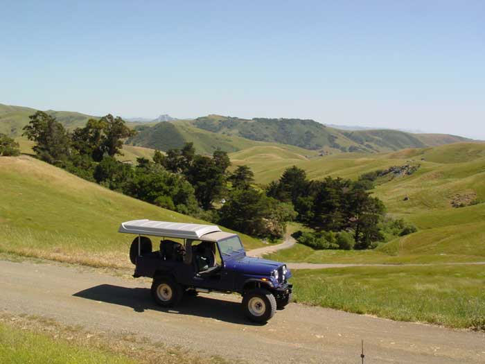

  9. #9
    Here is my Jeep. Her name is Mayahuel, The Agave Burro.
    The only thing I have not modified or changed is the right rear rigid brake line and now that I think about it...I think I changed that too.
