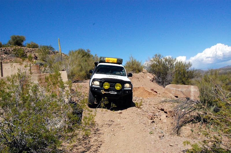

    What kind of lights? Size matters though there have been no issues with my 4Runner (I know I know totally different vehicle but also huge radiator) and I'm running LF 240 Blitz. I have always wondered about all the other crap that gets tossed on the front end and shied away from it.
