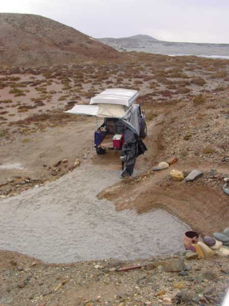

    As far open air goes, i couldnt agree with you more! The 3 weeks I spent in Baja (Dec. 2006), solo "open air" camping in Mayahual is one of the best adventures of my adventure filled life.
    A couple of thoughts about open-air campers....
    First off, I'm of the belief that 99.999% percent of the people in the world are "good folks" and are not going to mess with your stuff, unless...
    You provide for a crime of opportunity...Like leaving an ice chest full of beer unattended on a crowded Baja beach (like below Mulege), or a tool box sitting in the back of your truck. If you are willing to take SIMPLE steps like throwing a tarp over your stuff, or putting your gear in non-descript dry-bags, I in my heart of hearts believe that that your stuff is perfectly safe.
    But to be the devils advocate...Bolt some cables (with nico-pressed loops on each end) to the front & side to your bed...And then combo lock your stuff to the cables (I have all my combo locks set to the same number).
    another thing that i found useful, leave just a rubber mat for the floor and have a dry-bag just dedicated to the "home-stuff", like a nice throw-rug (that can be easily shaken out), curtins, oil lamps, etc....That can instantly turn your open-air camper into a "place of luxury", but can be stowed in a moments notice.
    Build a lock-box vault in your cab somewhere and put everything of value in it. Who needs a wallet when your in the middle of no-where? I have the ignition key to the Jeep on a loop of 2mm Perlon that i wear as a neckless, everything else of value is accessable with a combination....Or is just sitting there. MAN, the feeling is so liberating!
    Here is a thought...its a little out of the box, but work with me here...
    You know in houses where they remove a window and replace it with greenhouse / solarioum expansion outward from the wall???
    Ok, so now think of opening the side windows of your camper, folding out sections on both sides...that would create a transverce bed & storage area?
    Don't laugh!...At least you didn't have me on retainer (like my clients when I come up wacky ideas for them!).

    This is sort of what I was thinking about for your side doors/windows, except that the swing up door would make the roof when the tents are "folded" out.
    BTW: I just swipped this photo from a jeep thread...Thanks Lowenbrau!
