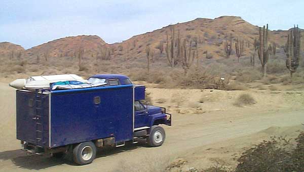

    So do I. I finally removed the generator on Casa azul because of how efficient the panels were.
    The key points about securing the panels are:
    * Making them secure and difficult to steal.
    * Making them so that they can be swept and angled to the correct degree and azmuth.
    * Possitioning them in the most impact free area while traveling.
    * Making sure the "F'en Gazilling $$$" pane dosen't go airborne in a heavy wind (Baja Nort'es).
    I set mine up so that they are attached to 2 pins (only on one edge) that attack to my aviation cargo track system on my roof. I then strap my surfboards over the top of the panel and off we go...
    When were travelling, the alternator is charging battery banks of course, so there is no need to be concerned that your panel working. when we stop for a period of time (sometimes up to a month), the boards come off the roof and the panel gets the rear pin disconnected and swept to the correct possition by using the front pin as a pivot and securing point (for those pinche nort'e winds).
    Here is travel mode.
