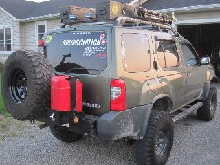

    Bender Built Rear Beer Bottle opener featuring tire carrier,Jerry Can carrier,Shackle Mounts, Hitch
    Reciever and third eye brake light.
    Custom Tube Bumper (Built by Dan at National4wd Smiths Falls)

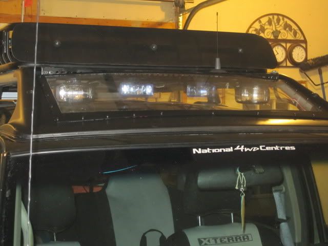

    4 roof rack mounted low profile spots -NEW-thor mod-no sunroof mounted lights behindhttp://i297.photobucket.com/albums/m...NATION/044.jpg

    Homebuilt aluminum cross bars below factory rack at rear for 2x Diamond plate tool boxes(for recovery gear) with
    12v acc.outlet/rear facing flood lights.

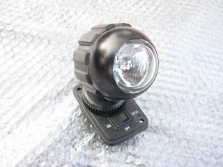

    Adjustable dual blue light map lights mounted to overhead light console(independantly switched)

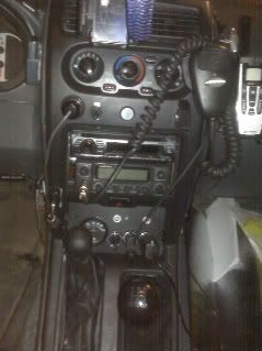

    Single Din Sony CD/Bluetooth stereo-Phone connection/Ipod connection et al.
    12v FRS radio with rooftop magmount antenna
    CB-Single Din TRC485 single sideband, powered mic.and external Speaker-Mounted in centre console below stereo
    Centre dash Console mounted Volt Meter accessory plug combo.3 plugs(switched) in bottom storage opening.
    Center console mounted toggle switches for outside box mounted 12volt outlet, and disconnect for rear hatch acc.socket (for 3way Dometic 'fridge)
