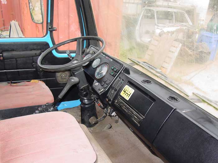

    The cool thing is the PTO was setup as the tranfer-case engage button on the dash (just like a 4x4).

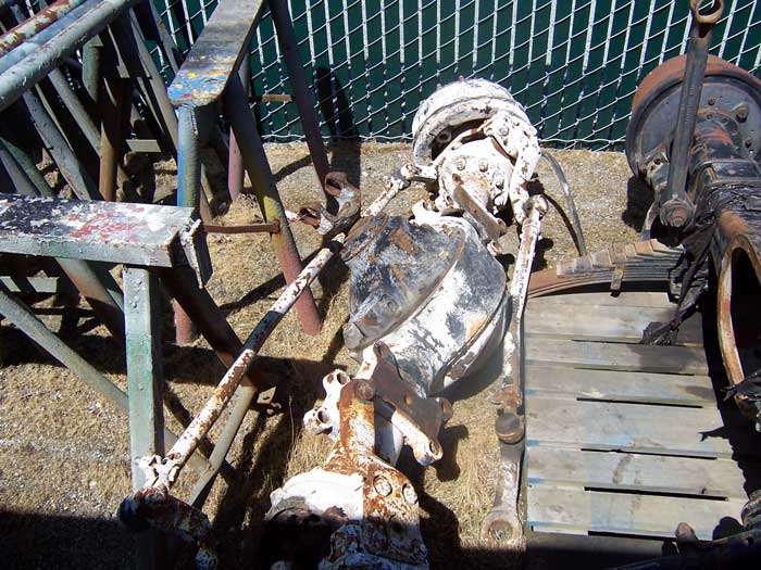

    I have an front drive axle in my backyard that I could use, however my "BIG 4X4 driveline" friend/Guru has 6 ton / 10 stud-hub front drive axle he is going to sell me for a song (he should, I traded him a cement truck sized t-case for ring / pinion's for my Jeep!), So I'm going with his axle. I'll give the axle a "lot of lov'in", possibly fitting it with HONK'EN dics's.

    The cab interior is in really good shape( after a bunch of scrubbing ):
    This may not look like much, but is is a "bad-***" axle.
