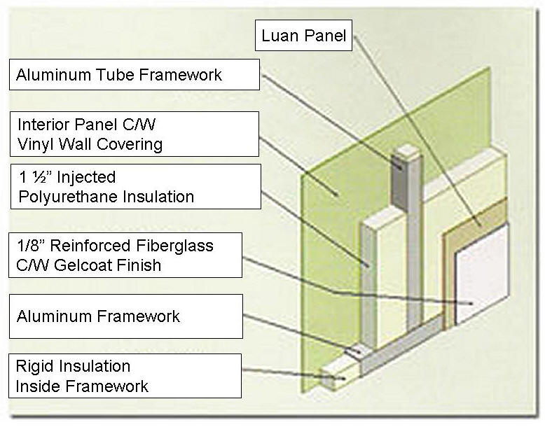

    Has anyone looked at the interior wall construction of a Bigfoot truck camper? I'm needing to install/build a drop down upper bunk bed in our 2500 series camper and I'm wondering if there are studs in the wall to tie into. Hate to pull the skin to see, but guessing that's my only option (unless someone has already been down this road). Specifically, I'm looking at the area around the dinette. Here's the plan:

    Some info here (scroll down):
    http://www.hackneys.com/mitsu/index-chassis-photos.htm
    As to what the spacing is...who knows. Sonic studfinder *might* work I suppose.

    Thank you for the reply. They had a 3000 series which used Alumn studs. I should have mentioned mines a 2500 series (clam shell design) which didn't use alumn studs. Can't remember if there are any studs. Seems like I once read there were some spruce studs in there, but not sure. Heck, if so, they ought to call them "stringers" as opposed to "studs" as its closer to boat construction than camper construction.
