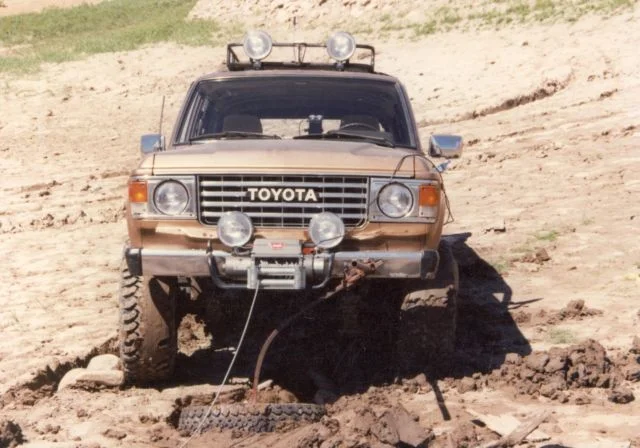

    I think that's probably a given with this rig; what I was saying is that 44" tires, plus the lift to fit 44" tires on an F550, probably means that he's starting out with the jack at 3' off the ground at least. Take up the slack in the axle strap/chain, and he'll be maxing out a 48" hi-lift to change a tire on level ground. I don't think I'd be all that excited to have a 60" hi-lift all the way up, exploring its weight limit.
    This is not mine, but that would suck to have that happen when you've got a wheel off of your F550. Even worse if you're underneath it! Get the load high enough and this would be a very real possibility with that big of a truck.
