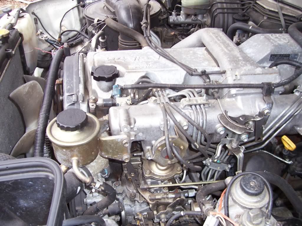

    After a lot of research, reviews by other owners I decided upon a 12 valve 1HDT. I really wanted one with a 5 speed manual but was told that was a very rare option as less than 10% of these truck leaving Japan came with a manual transmission.
    I contacted a few shops about doing the conversion, and decided to fall on the old wise premise of, “do it once and do it right”. If im going to go to all this headache im not going to attempt it myself, and im not going to have someone do this that hasn’t done it before. I wanted a clean factory looking install with everything working as it did with the gas motor.
    Of the shops I spoke too, Proffitts Cruisers out in Colorado and Salt Lake city were the most helpful, had the most experience doing this kind of conversion, and, well, just look at the vehicles that come out of that shop, man I was sold.
    Originally they were going to source an engine for me from Japan, however with the unfortunate Tsunami that happened over there, it didn’t look like it would happen.
    After extensive research, emails, phone calls, I was coming up short. Now let me just say, this isn’t a ‘money is no object’ thing – I am a realist, I have a job, wife, 2 kids and a mortgage, and knowing how a project like this can get out of hand money wise, and so I was prepared to wait and look for a deal.
    As fate would have it, a great guy called Bill, only 5 hours south of me contacted me about a half cut he brought in a few years back with the intention of doing a swap that never materialized.
    And get this … he said it was a 1HD-FT (yes the 24v version only available from 1995-1998), with a 5 speed manual!!

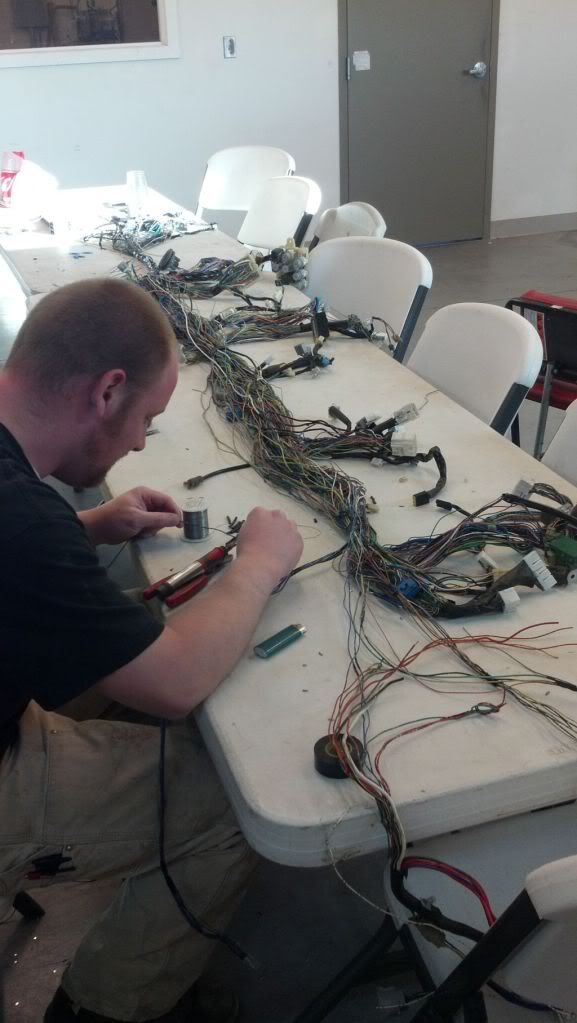

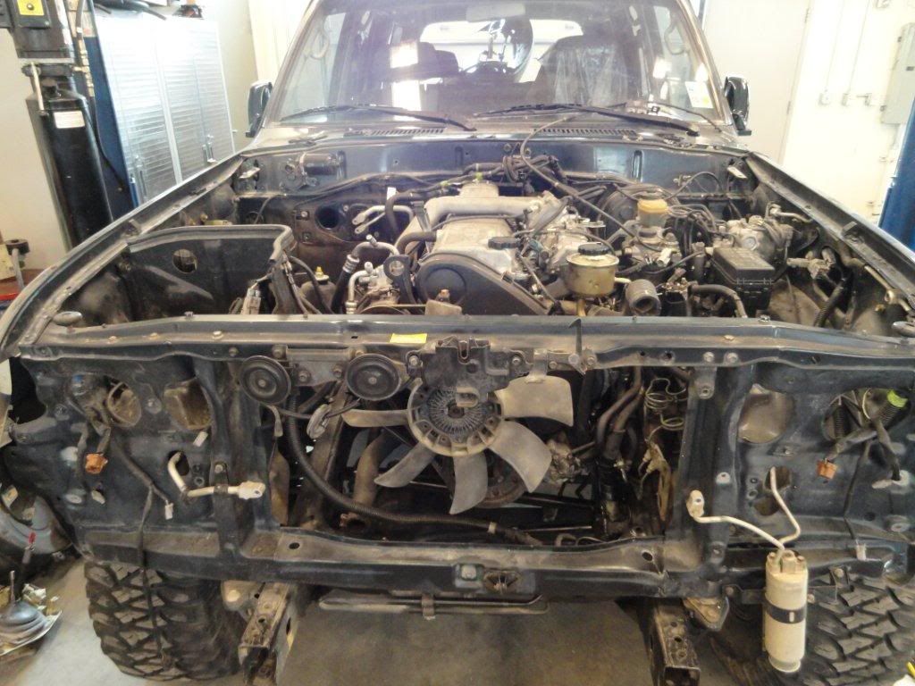

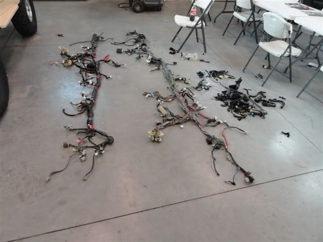

    Here is what was done along with the swap:
    New Clutch
    New Water pump
    New Thermostat
    New Timing Belt
    New BEB’s
    Rear main seal
    Injectors serviced
    3” free flowing exhaust
    Boost gauge
    EGT gauge
    Engine Going in:
    Wiring Harness from gas engine and diesel engine being joined in holy matrimony!
