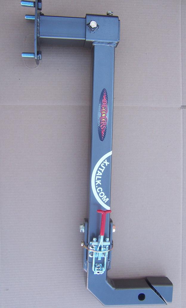

    A really nice option is the Detours USA Knucklebone Tire Carrier. Basically it is a receiver hitch mounted fold down tire carrier. Mark at Detours will custom make the mount to direct bolt on, you name it. They are great and only a couple hundred bucks. If you are on Facebook "Like" Detours USA and check out the photo gallery for the Knucklebone, or do a search on Google and there are some pics installed and so on.
    If I hadn't already opted for the Detours Tailbone rear bumper, I would have opted to one of these with a custom mount to bolt to my receiver not insert into the hitch.
    That thing looks like cheap junk, how large of a spare is it rated for?

    As for the Detours Knucklebone, I do not know what max tire size is possible? I would venture a guess a 33"? It is not junk I assure you. Mark @ Detours does a nice job on the fab and this includes a swing, anti rattle shim, positive latching system and adjustable head for backspace adjustment. It is a great option for people not running 44" boggers and needing a tire mounting option.
    Not everyone can afford a $1500.00 rear bumper with a carrier or has the skills to make their own.
    edit: I think that is a pic of one of the prototypes...
