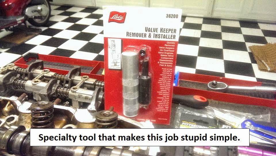

I like your spring removal tool, never used that type
luck,greg
Hello Greg, up until the other day, I had never used that tool either. I was at my local Baxters auto parts store and I mentioned that I was going to be performing this valve seal job to Jesse one of the employees. He told me that he also had done this countless times over the years as a professional mechanic working for the Toyota dealership. He asked me if I was going to perform this job with the heads on or off the engine. Then he told me about this Snap On tool and that helped cut down this job into minutes. I found the same tool in a different brand for much less. After having used it once, my only tip would be to use a heavier mallet.
