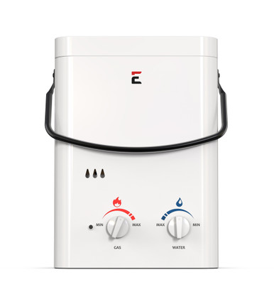

For actual heated water I would look at portable propane instant water heater. Seen Camplux brand installed inside and outside of campers/vans and generally have positive results. For example: https://faroutride.com/eccotemp-l5-review/

I have had success with the Eccotemp portable LPG units. I currently have an L5 that I just set up in my never ending camper project... and had an L7 in my last offroad trailer.
These package deals are pretty good, they come with a solid 12v pump and a particulate strainer as well as the shower wand and LPG hose. They work amazingly well and generate a ton of on demand hot HOT water. Plus if you don't want to mount the heater permanently you can mount it, use it and put it away.
Ecotemp is garbage. I bought 3 of these before I finally got one that worked (80% of the time at best). Poor customer service, lies after lies. Finally they admitted that they had a bad batch of parts (the saga of shipping and returns went on for over a month). They made me take apart two of them and attempt to “fix” them myself before they would even accept them as returns. Now I have one that works “most” of the time but will randomly shut down during a shower and spray cold water on you. Junk product from a junk company.
I haven't had the same experience. If I did... I picked mine up at Costco so its a quick return and done. My L7 worked flawlessly but the shower wand was cheap.
