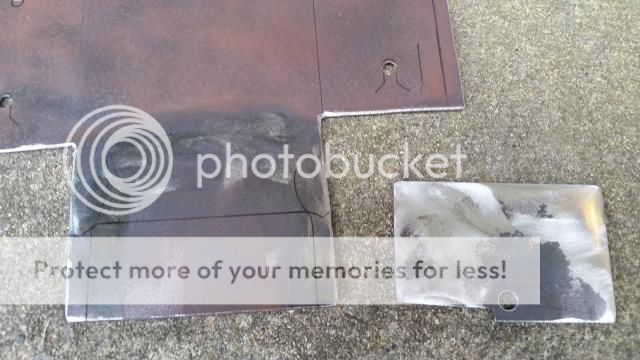

So with the box out you want to cut it, I suggest following the line they suggest in the video and then modify from their if needed.
The part of the tray you retain:
The cut M.O.R.E. suggested:
They suggest you wallow out these two hole to allow the trays to fit together. I missed that in the video and glad I did I think my way was might more effective.
I made additional cuts to be trays this cut allows the trays to sit not only closely together but to inner lock on one another. No need to wallow out the holes if you use my method. Also it helps support the back of the air box tray.
No loss of space with in the tray but edges fit together very smoothly. I like it.

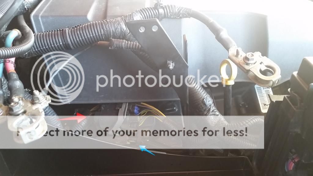

Aother change I did was I did not like how the harness mounted:
So I moved this like it is right above the ignition coil, I just moved the evap hose down to the lower hose added chaffing gear and put the plug in the top hole. Plug will not fit in the bottom hole it hits the battery box.
Evap hose is blue arrow plug relocation it the red arrow.
Now to the part they did not cover in the video very well. The EVAP hoses have to be separated they do this i the video but do not explain it as a step. This took a little bit to figure out but these hoses can be discarded.
Not a great picture and out of order but I edited it and added red and blue arrows to show where the hoses normally got. The EVAP solenoid is not really in the picture but this is the section of hose that would be tossed out.

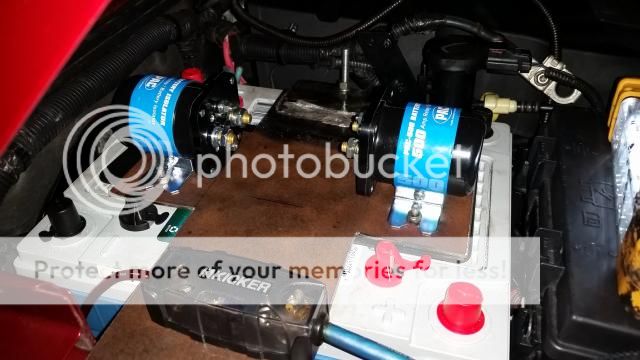

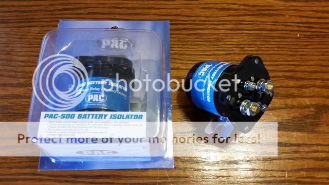

My hold down will have two solenoids mounted to it one for battery isolation and one for winch isolation so I can turn the power on and off to my winch just for safety reasons. Winch is rated about about 450amps at full load, the solenoid I chose is rated 500amp continuous duty, 750amp spike. When I get my 2nd battery installed I will hopefully have the hold down built and all the wiring complete. If you have bee considering a dual battery set up hope this helped you decide.

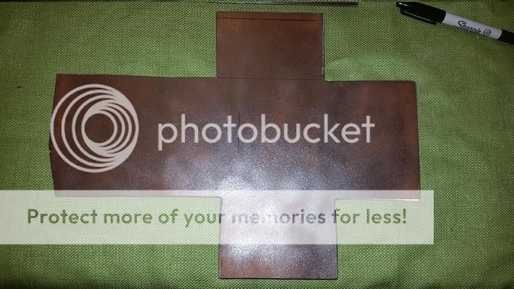

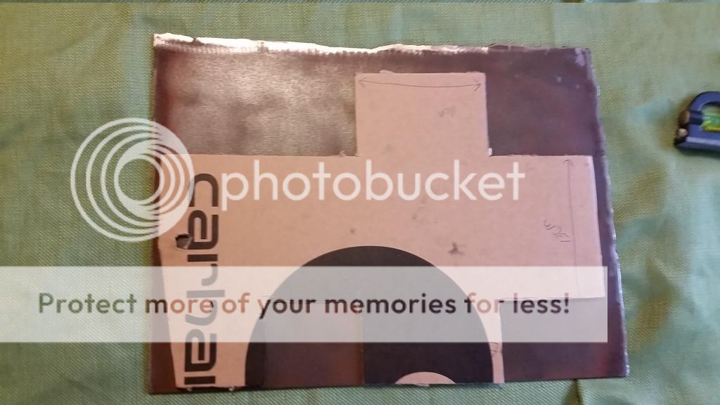

Hard to understand at this time but got the frame of my battery hold down built.
White area is to be removed.
Frame cut out, this will bolt across the top of the batteries, on the left where it angles in is a OEM battery tray bolt hole will be re-used , also it is angled to follow the body line of the fender frame. On the other side will be a section of insulated all thread holding down the side closest to the engine, going to get it on the band saw and straighten out a few cuts but coming out nice.

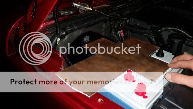

Edit: could not resist I had to go take a photo of it in place. The OEM bolt is sill installed so the bracket did not sit flush but hopefully my 2nd battery will be here Friday and I can get this fully installed.

My solenoids was waiting on me as well: (these things are HUGE)
The hold down I am working on, All I have is a chop saw so was kinda tricky but I got it cut out did not come out the way I planned but I may build another one later.
Options for placement of solenoids :
This is the one I chose:

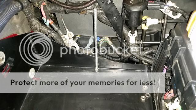

Drilled a hole in the tray and double nut locked the all thread in place then covered with 3/8 hose for chaffing protection.

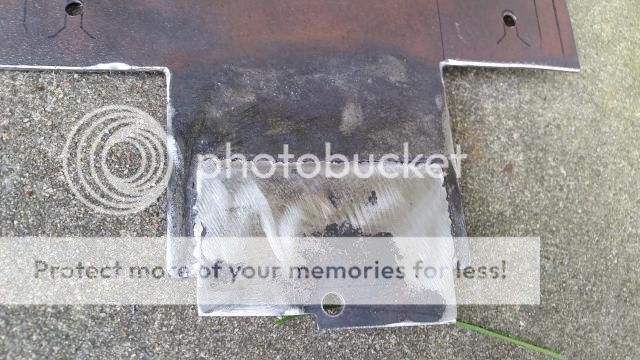

This should have been one piece but I cut it short.

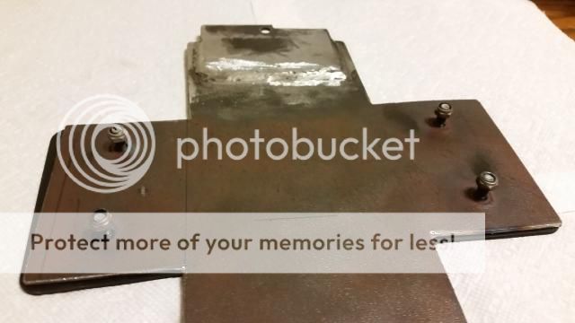

Welded the studs in place from the bottom. these will hold the solenoids
This is about as far as I got tonight. working on building wiring. gonna make sure everything is good then pull the hold down and paint it. I have some left over Deep Cheery Red to match the engine bay so gonna do that.

Thanks, this install was very easy I took my time and drove the wife's car a lot. The Genesis set up is really great but $$$$ they want $250 for the tray with out any wiring. I went to Napa auto and bought a 69" battery cable in red and black. It was cheaper to buy these and cut them to length than buy just wire. All my connections are soldered, anti-seize for anti corrosive, and heat shrank.
Tray: $135
Batteries: $189 x2
Solenoids: $48.50 x2
Cable: $14
Cable ends: $6
Military Spec lead battery terminals : $18
Metal for hold down and all thread: $20
Patience and attention to detail: Priceless
I still have to straighten up wiring up some. Going to shorten the red cable going to the rear battery. Also when my last set of terminals come in I will fasten down the cross connect ground wire it will run buy the rear solenoid and tie into the ground post from the opposite side that it is at now.
