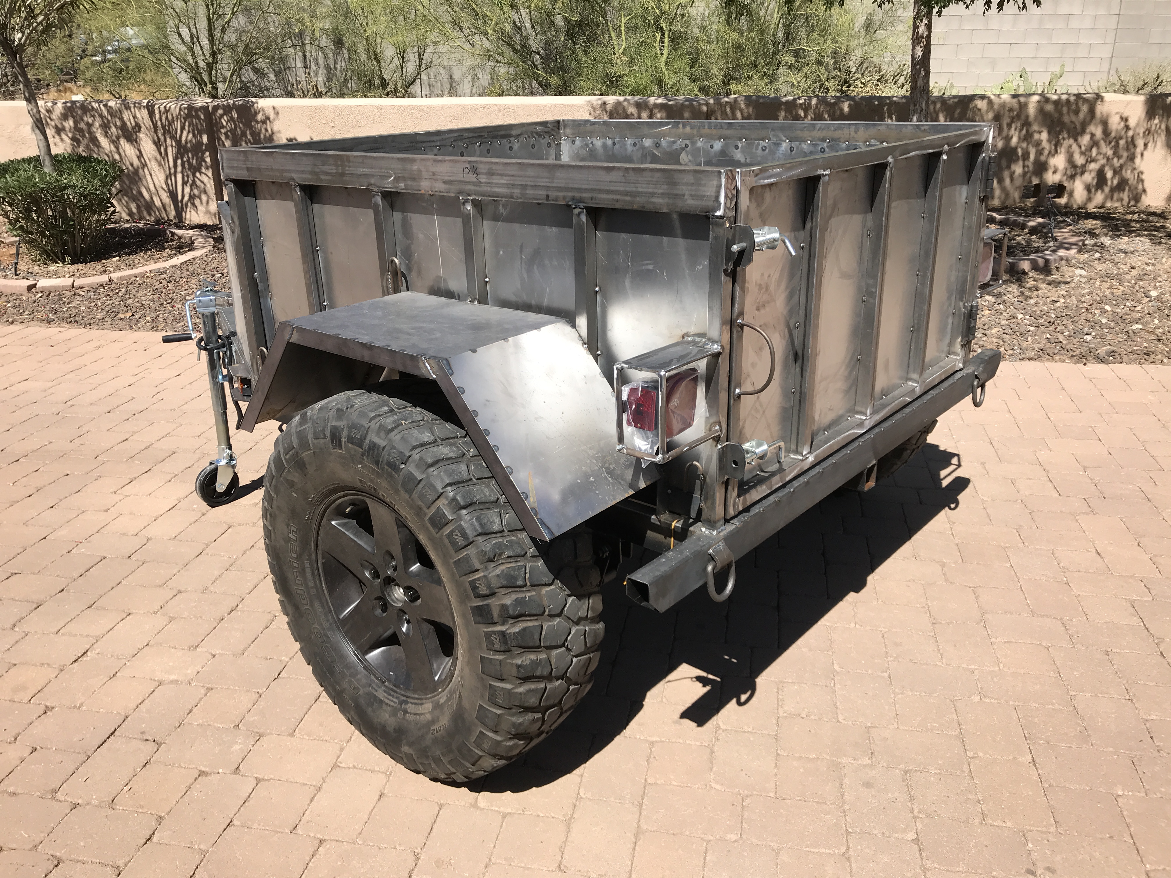

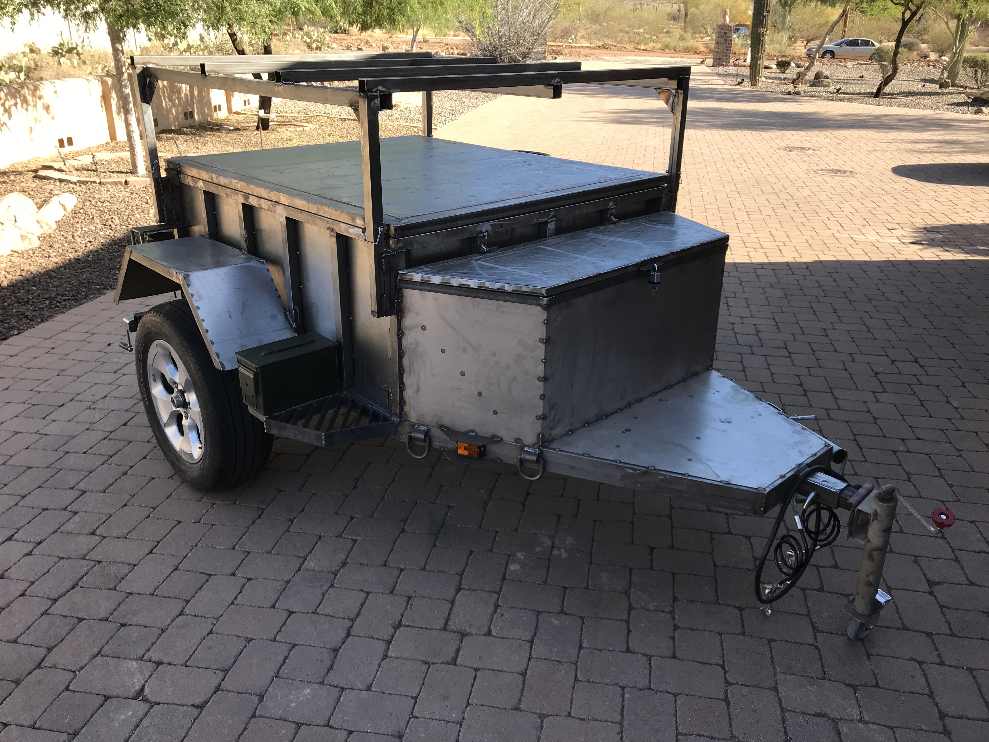

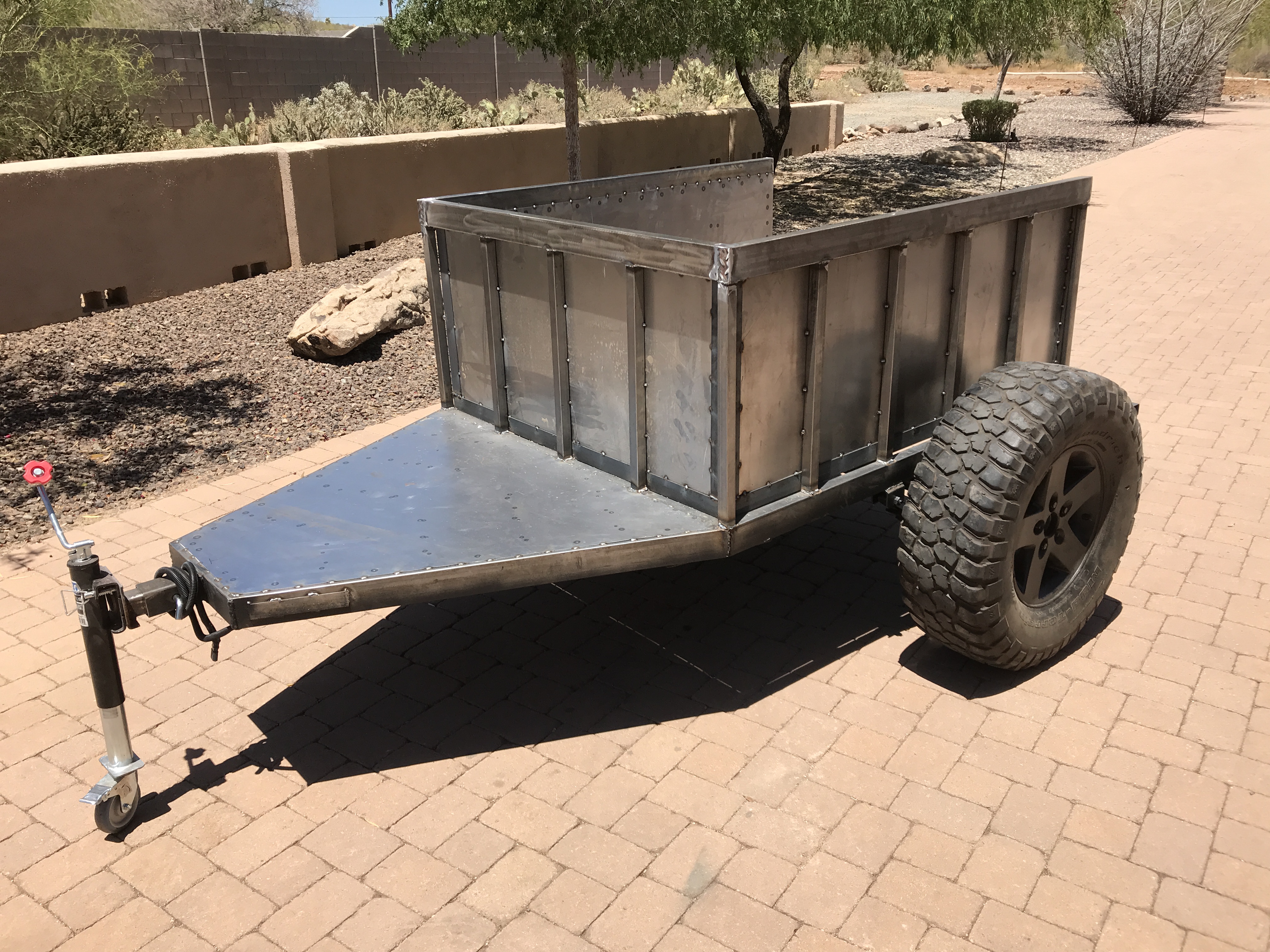

Hi Everyone,
I see a lot people building there own trailers so maybe I can help some build a M8A1 style trailer?
I built a jig to build my off road trailer, perfectly square and perfectly level. I then built a rotisserie style frame holder to spin and weld the frame in any position and also to weld all joints in a flat weld position.
I used 1.5” x 3” x 16 ga. Rectangular tube strong and light weight.
Also, this makes it super easy to wire the electrical.
I use 5/8” square tube as conduit to run all my electrical wiring through, this way driving over rocks and bush will not effect the electrics.
I used a 3” axle tube rated at 7,000 lbs with 10” electric brakes. 5 lug on 5” bolt pattern.
This trailer weighs about 850 lbs. with the side wall vertical struts it is very strong!!!!!!! The side walls and tongue wall are like steel GIRDERS on a metal building...exponentially stronger.
2 rear bumper leveling jacks

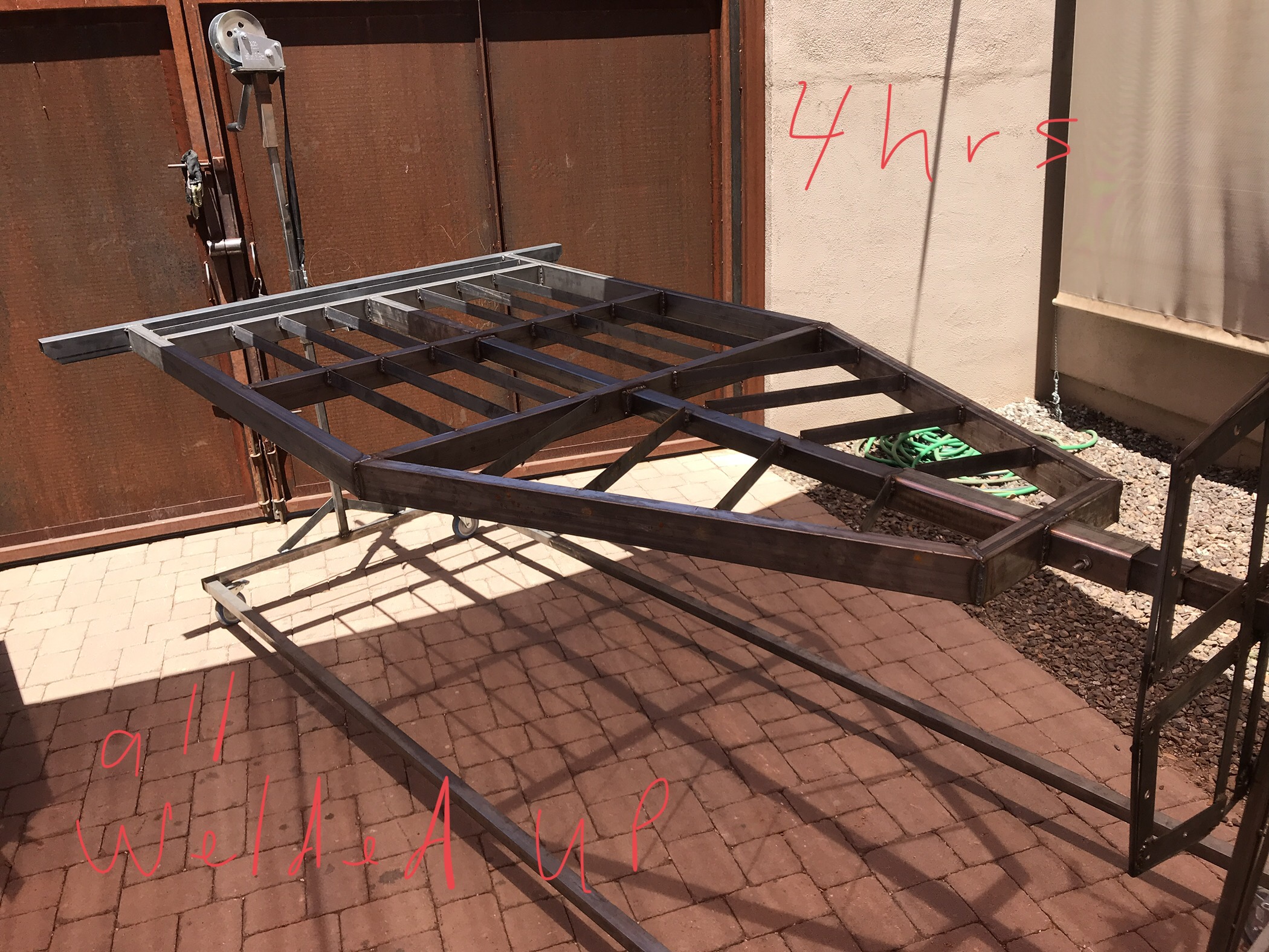

Here is the main jig and measurements of frame beams
Welding the support struts on the rotisserie jig

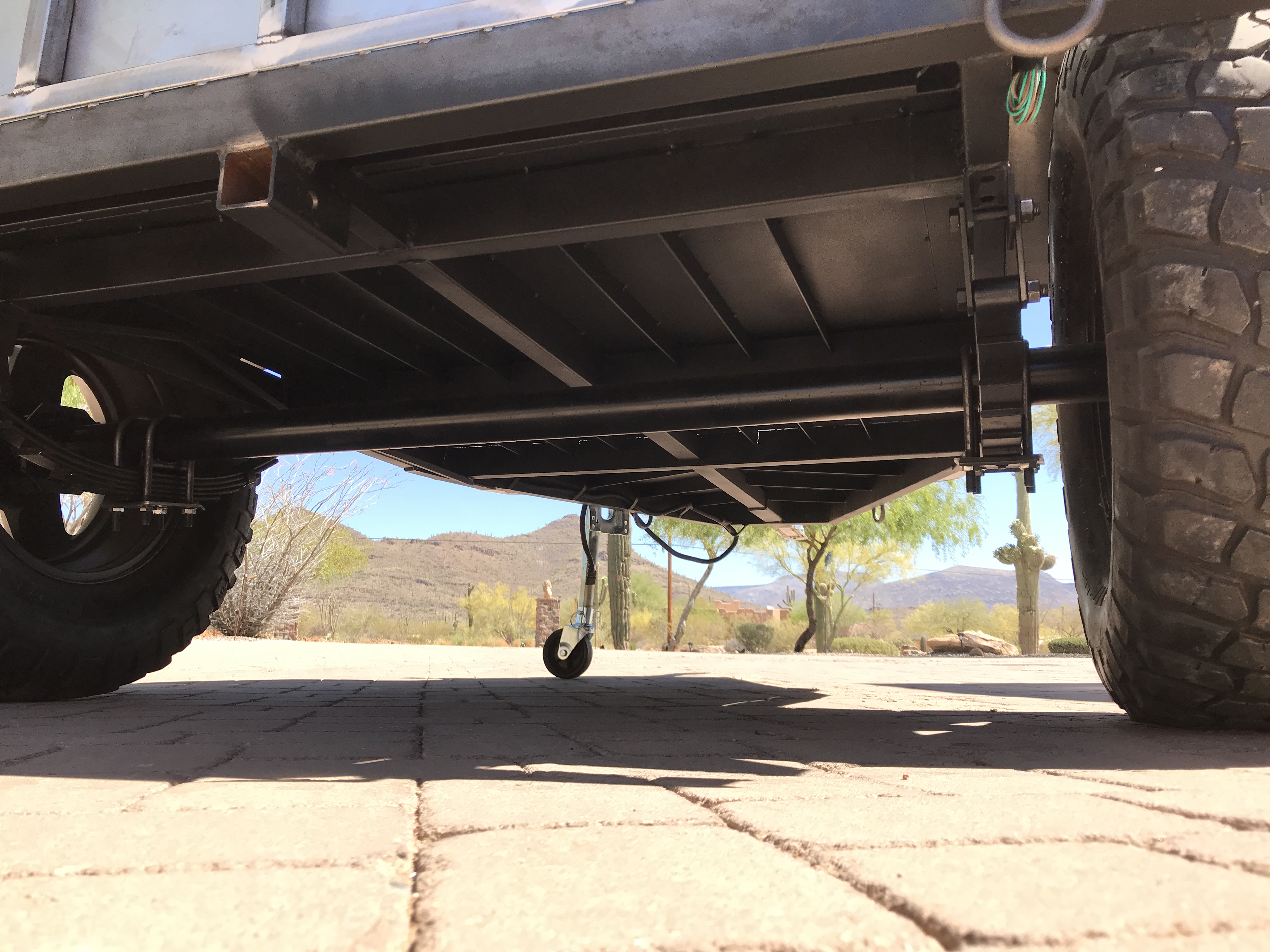

More details on the underside all welds finished ready for axle and leafs
https://youtu.be/mNlrGl-ufrU
Leaf spring hanger bracket placement
Lower frame finished

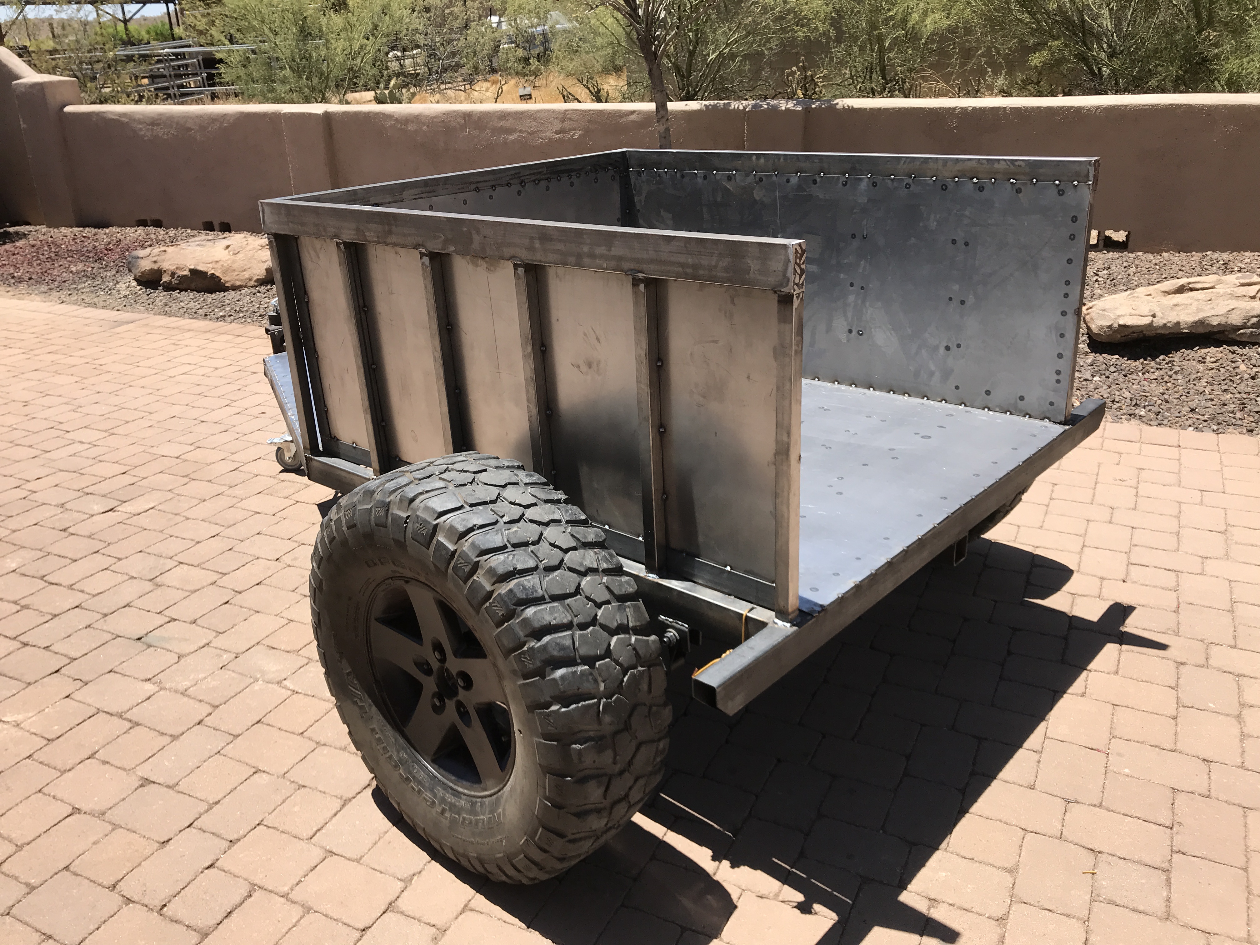

Deck weld joints
https://youtu.be/DPw7bNjkjmA
Deck inspection and next
https://youtu.be/MZKgHS62ekI
Deck sheets finished
Black bed liner coating underside
Box posts on with top rails
https://youtu.be/5gks3gPEhm0
Axle build specs
https://youtu.be/BzTU4y8weQ0

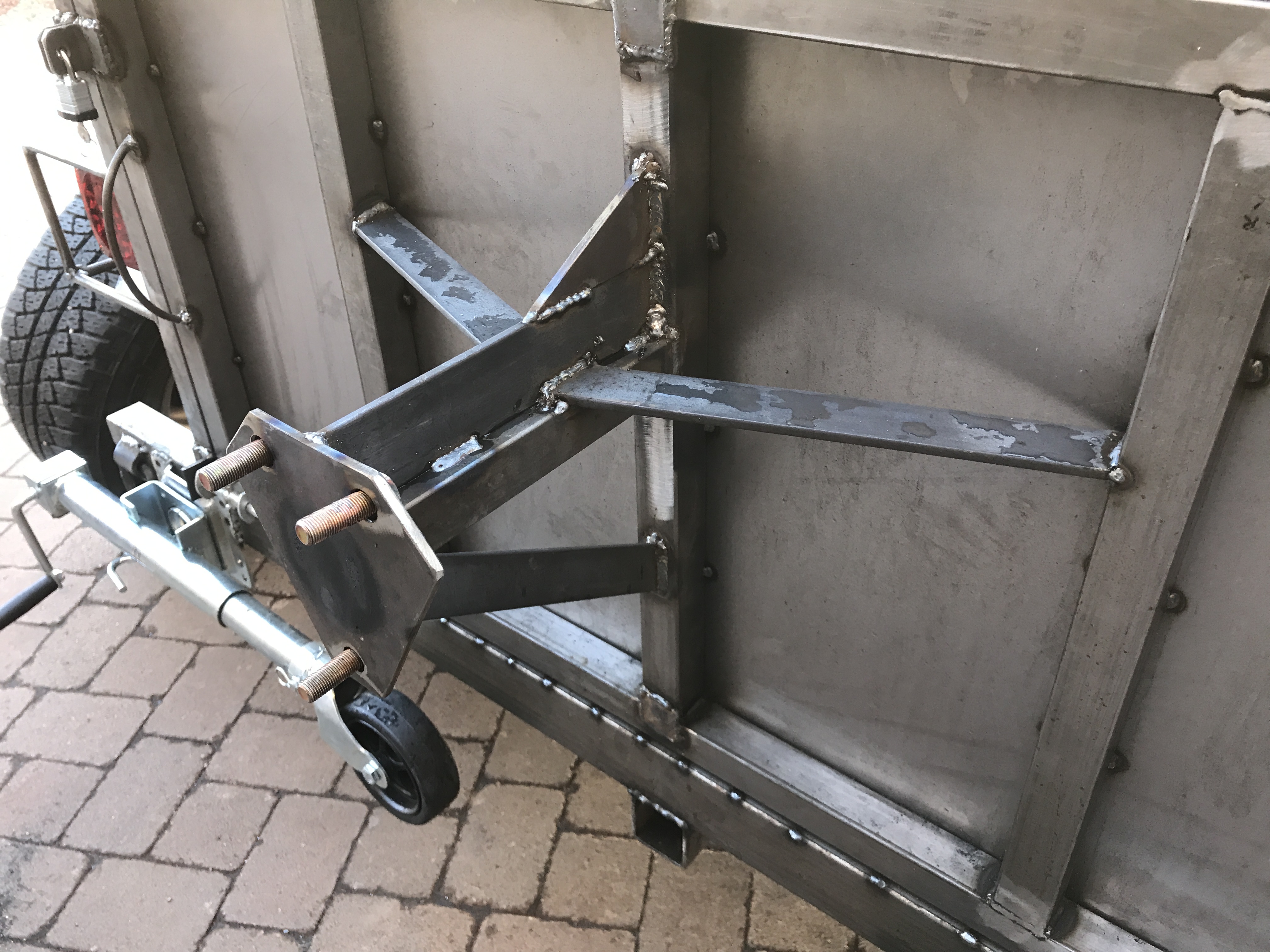

Here are some pix to show details and the versatility of the rotisserie frame holder.
Plz ask questions

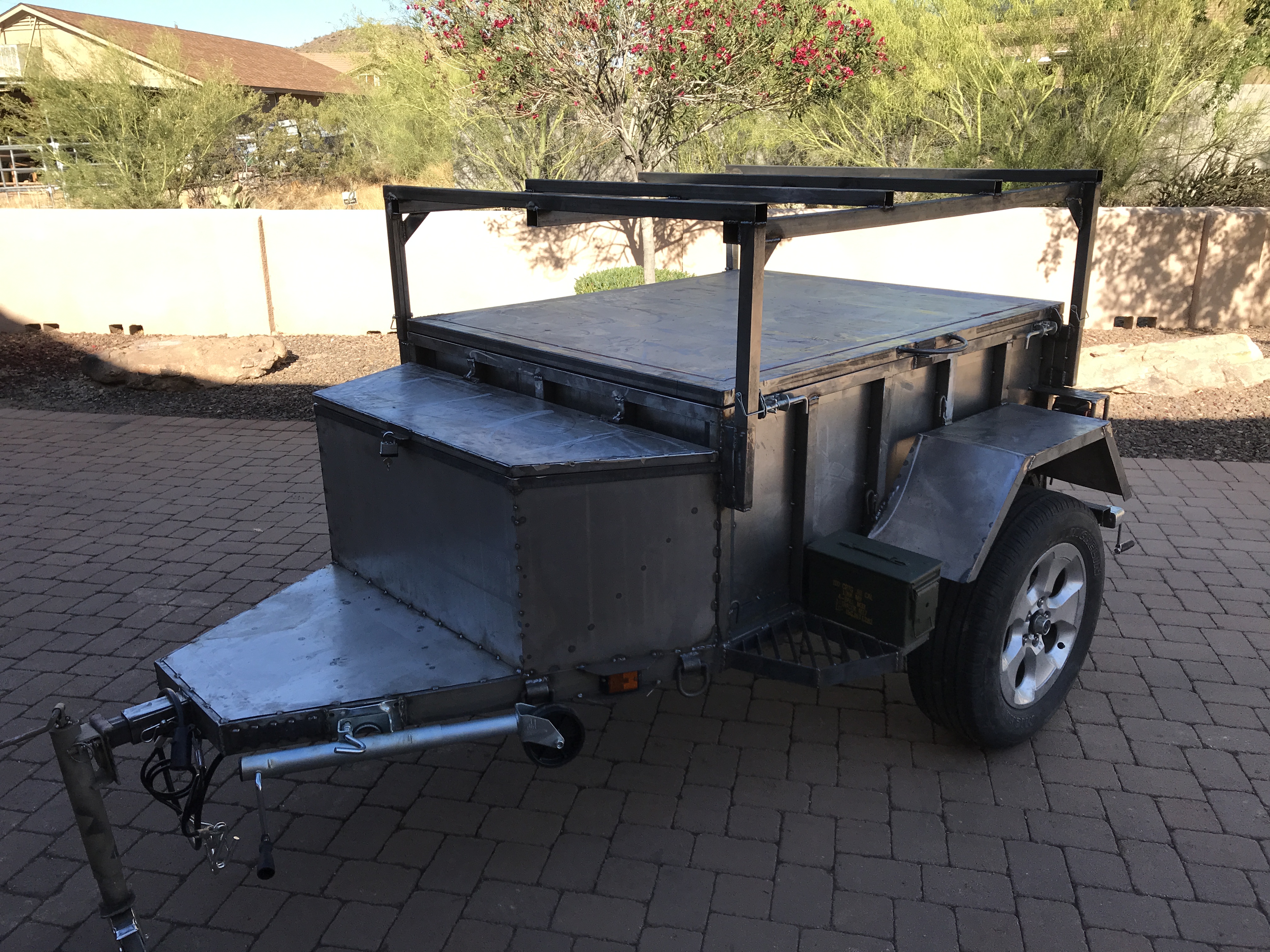

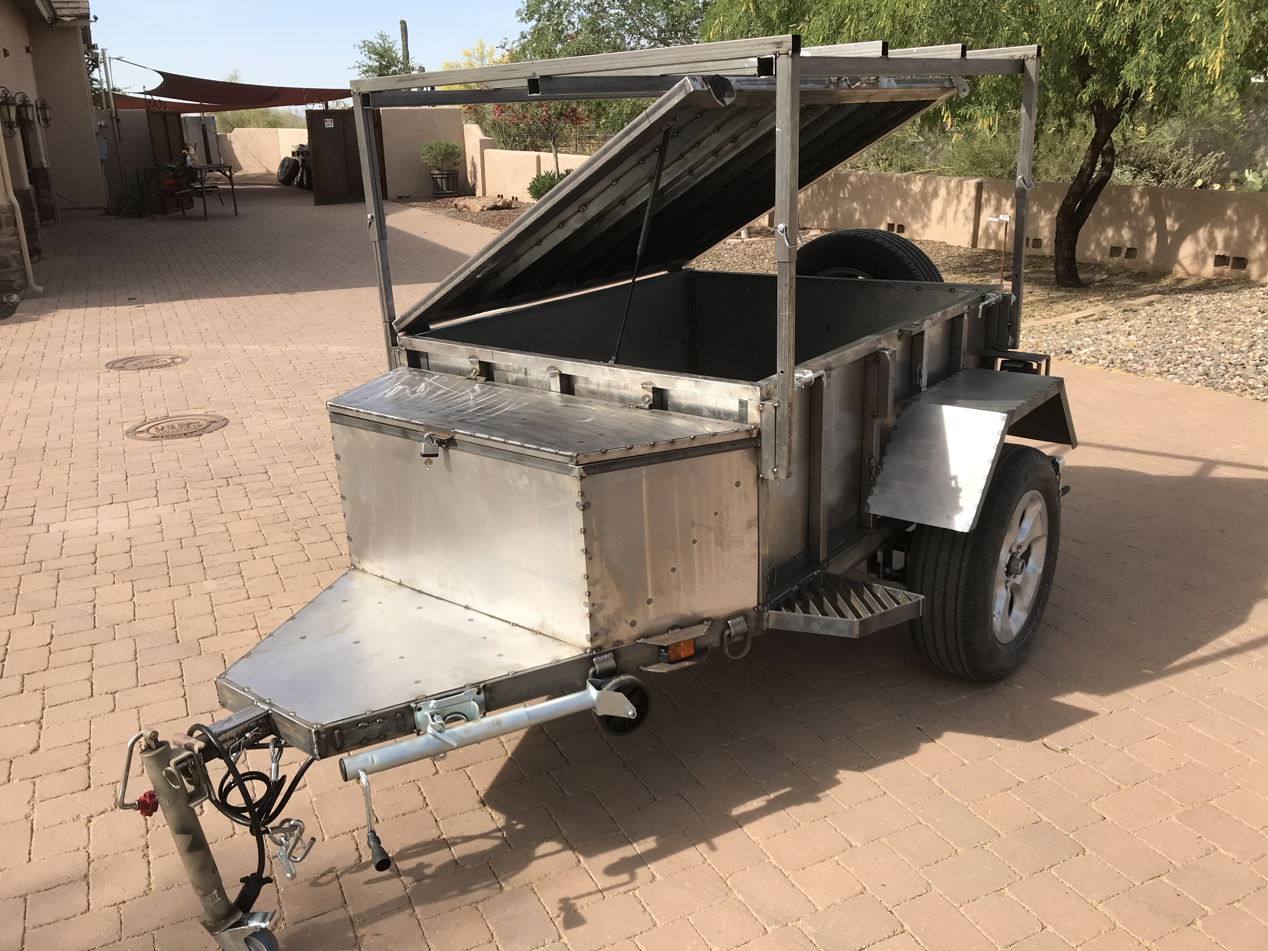

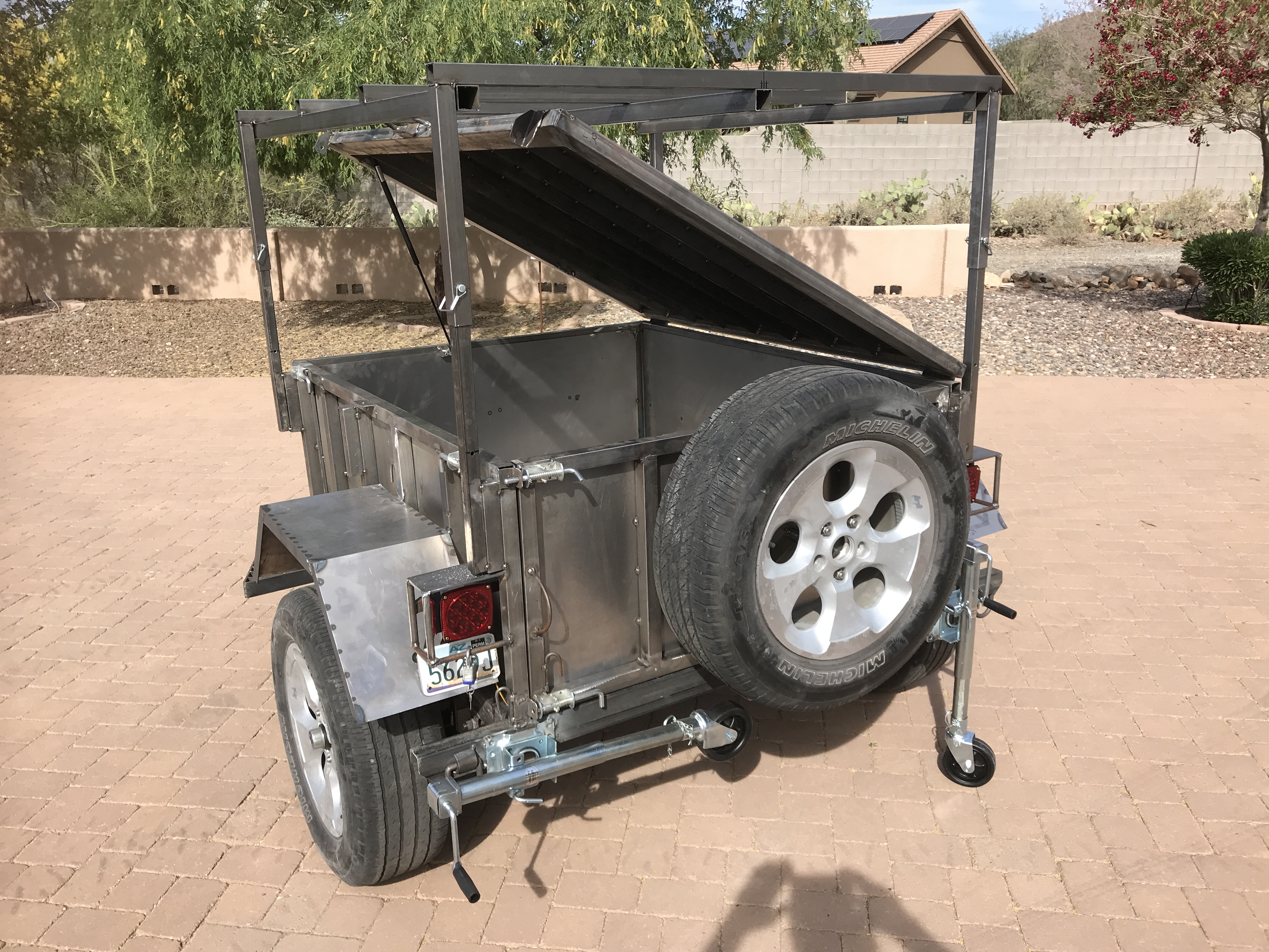

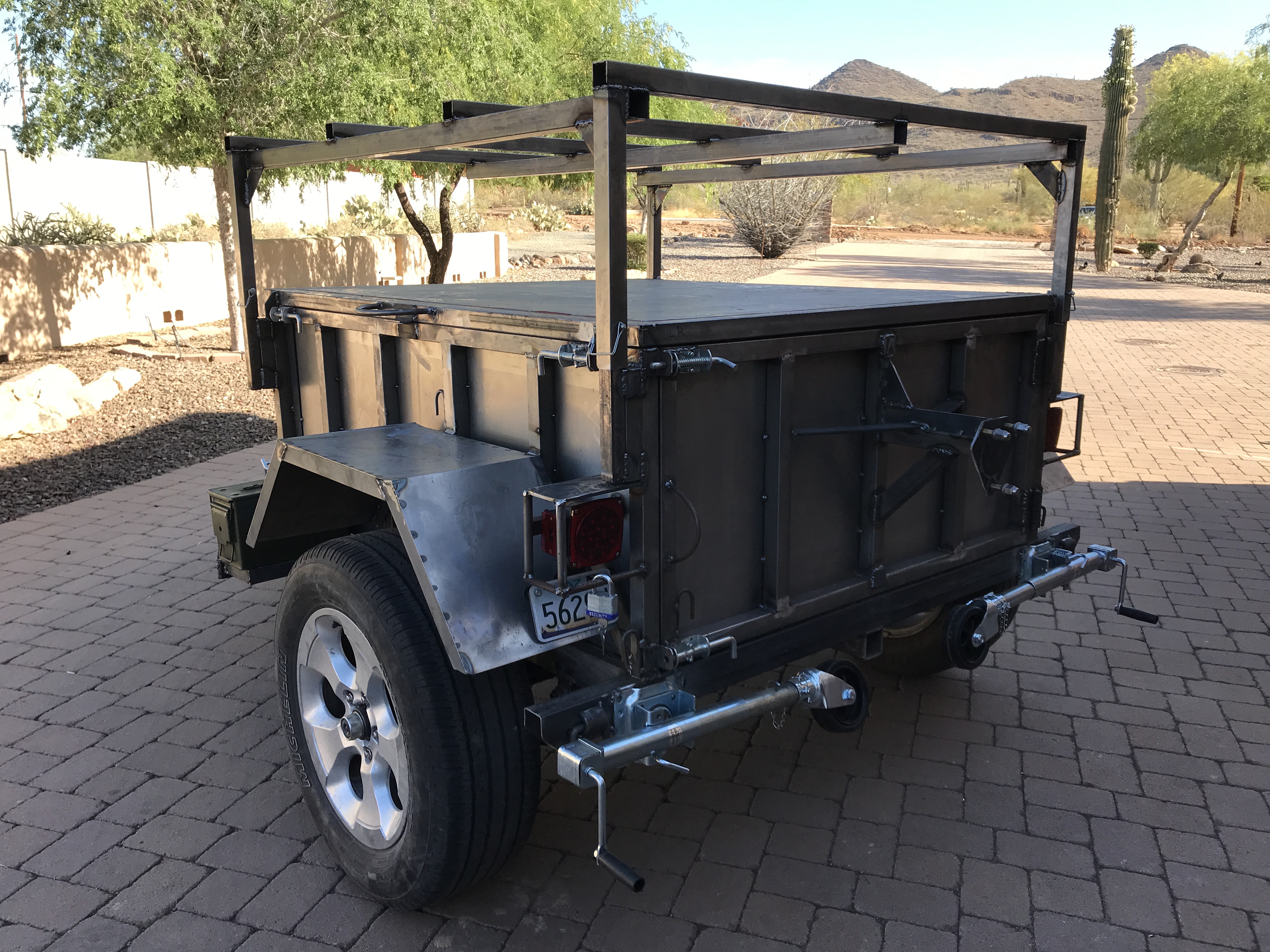

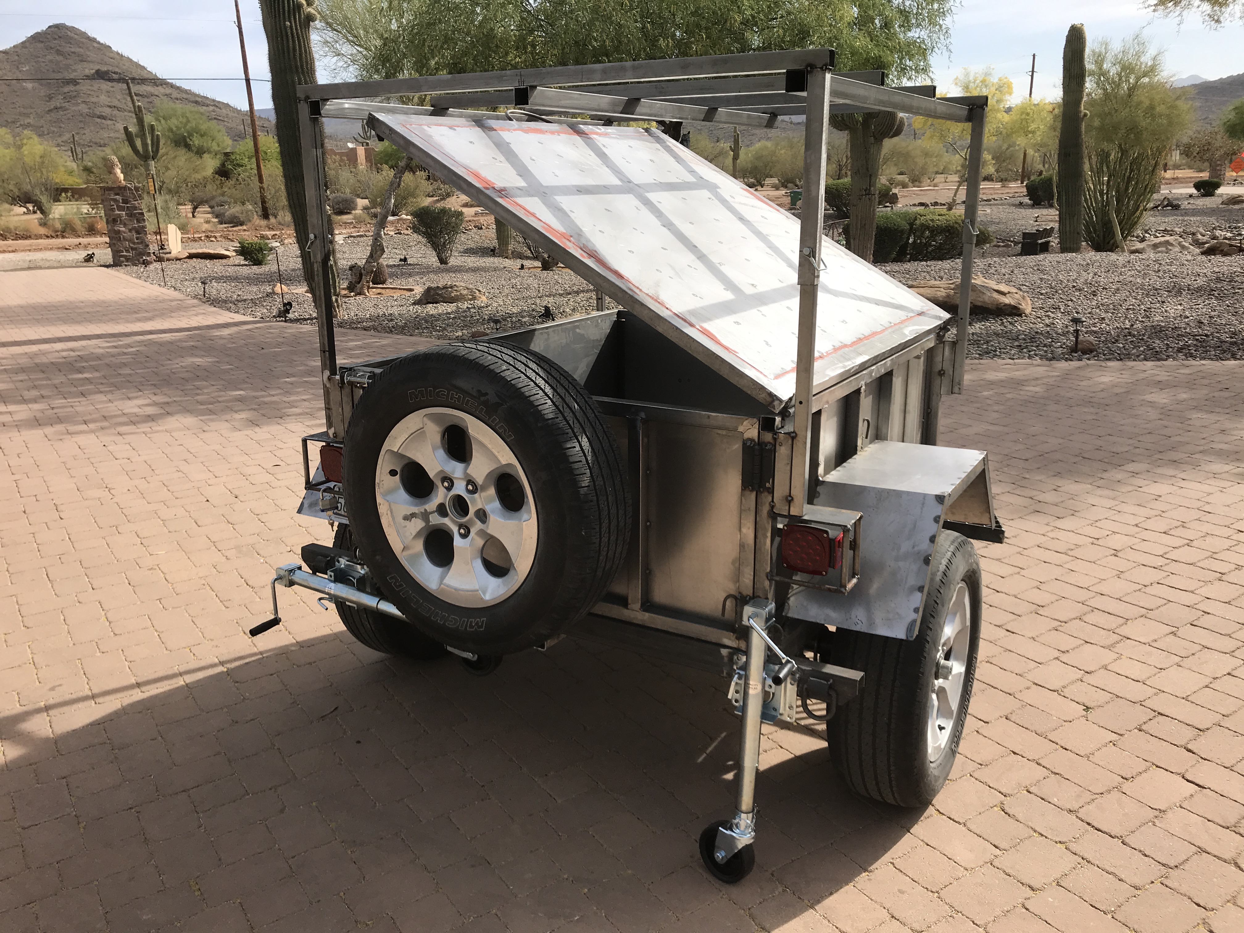

A few more photo angles
2 bumper leveling jacks
Adjustable External tent mount
Lid with SUSPA gas strut
Lid on fuel storage box
Sahara Jeep take off wheels
Spare tire mount

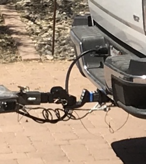

I chose the max coupler for a hitch system
