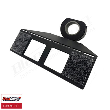

I am looking to mount a scan guage in my xterra. Just about everything is mounted on ram mounts in my truck. That is a gps, dual band head and 2 mounts for a cell phone and ipod. I think I would mount it above the gps on the a pillar but I am wondering if anyone has come up with a mount for the scan gauge.

My favorite place to mount the SG is on top of the steering column with 3m double-stick tape. That's where I had it on both of my 4runners and it worked great.
On my last 4runner and on my Suburban I had a RAM 1" ball mount attached to the dashboard with the same heavy-duty 3m mounting tape. On both vehicles it held very well (even in hot weather) and removed without a trace when it was time to sell the truck.

I made a bracket to hold mine up above the rearview mirror. Obviously this was easier to install since I had the headliner down for Pop-Top work. The Bracket is just bent to the shape of the header at the top of the windshield, and then I used two pieces of thin aluminum angle stock to hold the Scangauge and riveted them to the bracket. A little work with a file made the clearance for the RJ45 connector for the cable on the backside. Sorry for the lousy photo of the "empty" holder, it's cropped from the bottom of an image where I was shooting something else. I don't think I ever took a picture of the empty holder directly!

I mounted mine to the steering column as well. That way, it's very visible, easy to see and out of the way.
It does cover up the gear indicator but haven't had any issues with that.

I mounted my Scan gauge on the steering wheel column of my 2013 Land Cruiser. Easy to see and mount.
