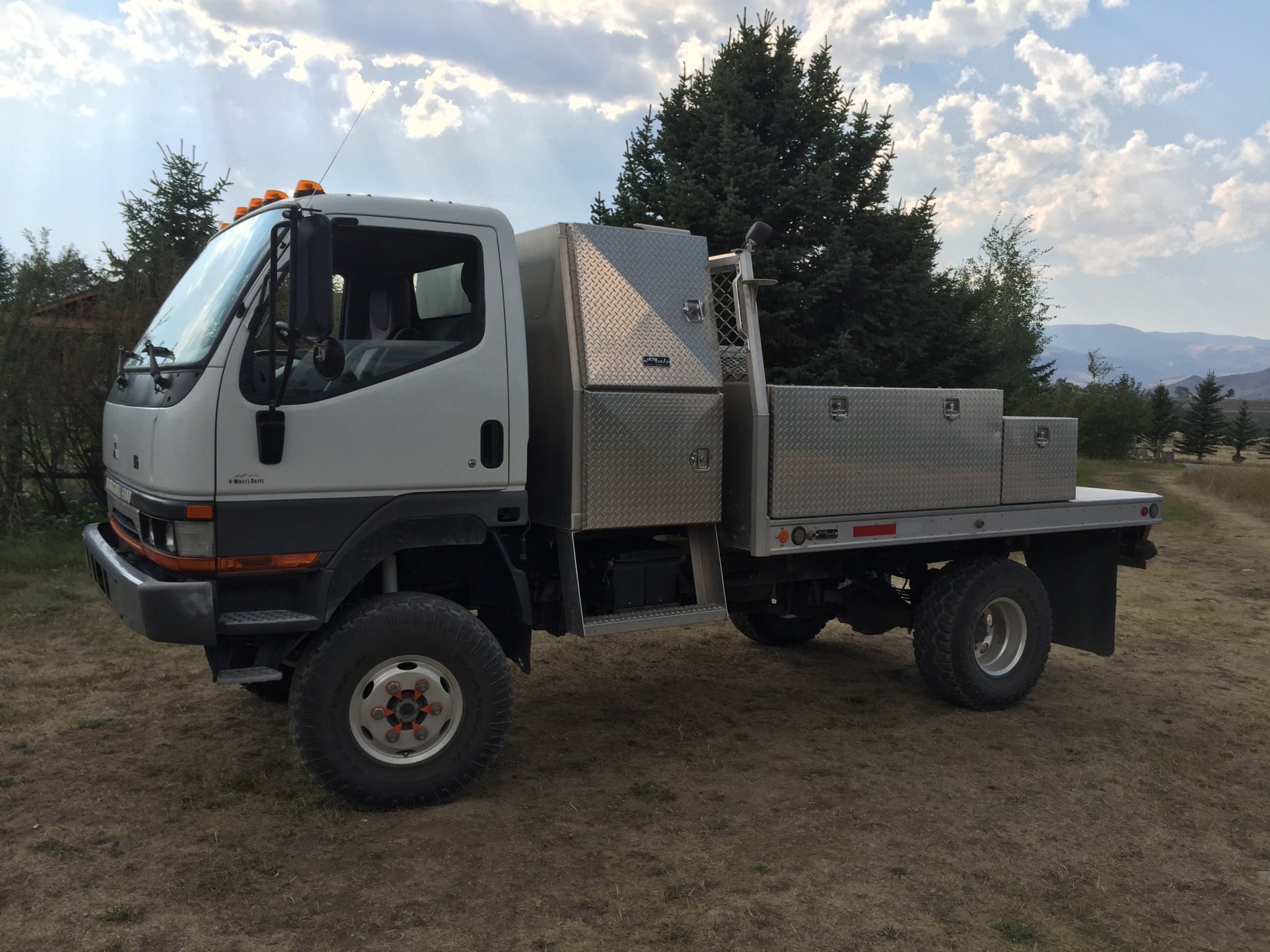

If you have been following my posts, you will realize that I bought a 2007 Fuso and moved my camper from the 2004 to the 2007. This truck was originally FusoFG's and was an expo rig from day one. No plow use or heavy commercial use. It has <74K original miles and has never been in an accident.
Standard on the truck:
4 cylinder 3.9L turbo diesel
5 sp manual transmisstion (5:38 : 1 low gear)
5:71 gears with Posi in the rear
Fuso suspension driver's seat
Power windows
Power door locks
A/C
Stereo (new)
Block heater
4x4 with 2 speed transfer case (2:1)
Exhaust brake that is so powerful you will seldom need the brakes
Truck Specs
Max GVWR 14050 lbs
Payload 8515
Wheelbase 133"
Usable Cab to Axle 107"
Overall Length 217"
Added to the truck
National Air passenger seat
ATW parabolic leaf spring suspension (1 yr old) with Big Bore shocks
Earthcruiser 16" Alum wheels with Goodyear Duratrac 315's (<4k miles)
Protect 10' with a tool shed next to the cab.
Drop a camper between the tool boxes and GO! Or better yet, take this to Earthcruiser in Bend Oregon and have it converted to a world travel ready Earthcruiser. No ULSD and No DEF requirements. There are very few of these in this condition and even fewer (if any) with the suspension and wheel mods.
Price is $32,000 and will consider part or full trade.
*updated Jan 29, 2016
*updated Feb 4, 2016 more details better description of the truck

Dave, yes ATW is All Terrain Warriors and these are their parabolic. I bought them and installed them last Fall. Since the springs and wheels, I have put less than 4k miles on the truck. I don't think FusoFG had a build thread, but he was meticulous about the maintenance and care of his rig. He always waited for the temp gauge to move before driving and was religious about 5 minutes of idle after freeway driving. The truck was well cared for and not abused. They had built a custom camper and the total loaded weight was 10k evenly distributed between front and rear.

It was a custom built box 13' long 7' wide. It had fixed rear mount and front pivot. Pic with camper on 2004 and flatbed on 2007. Now they are swapped and the 2004 has the flatbed...I will throw in a set of steel 19.5" wheels with m608s mounted (tires in fair condition)..look closely and you will see those are on the 2007 in the pic

Box was built by Race Coaches of Milan GA in 2005 under the design of the previous owner. It's a thin walled rectangular steel exoskeleton with sheetmetal siding. The top and floor are metal covered plywood. The only beefy steel is the cross member for the pivot. This camper has been to Alaska throughout Canada and the US. I found 2 areas where the camper frame was cracking and have repaired, so I am very pleased with the construction technique.
2004 vs 2007: The 2004 has better off road setup. It has 5.71 gears compared to the 4.875's in the 2007. Additionally the 04 649's transmission has a 5.38 1st and reverse gear. I don't know what is in the 2007, but it does not seem that low (could be the diff gears making up all of the difference). The reason I changed was I am 6'3" and I while I had plenty of headroom, I always felt cramped in the cab. The 2007 has about 5" more cabin space. Then there is the bigger engine in the 2007. It has a 4.9L vs the 3.9L in the 2004. I was surprised that I didn't see that big of a difference in performance between the two...a mountain pass I was climbing at 40-45mph in the 2004 can now be driven at 50-55mph. So in the final analysis (in my case) it was leg room! That was an expensive lesson.
